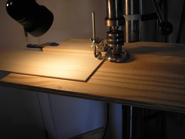

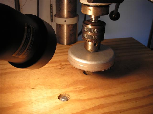

Mike I use a Wagner in the drill press for all of my back and side thinning, I find it very efficient if kept sharp, as of course all your tools should be! It's also great for fingerboards necks etc, wouldn't be without it.    Make a good table, fence and hold down and it will work fine. Finish off with a drill press sander or ROS.

Mike, I like the Wagner for thinning backs and sides and tops. It works well for me and I use a disc sander to finish up the swirl lines from the Wagner.

Dave, nice to see pics from your shop bud!
